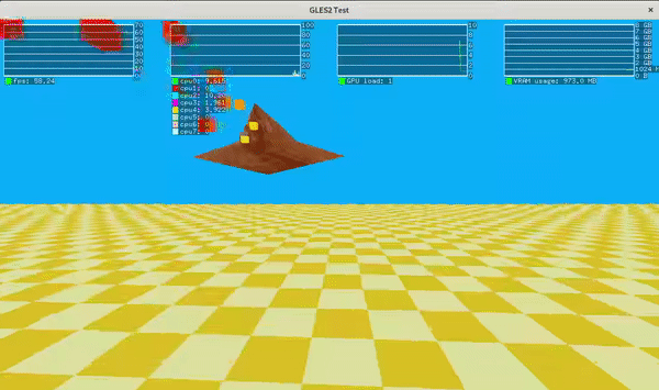

I've introduced batch rendering to improve the performance of rendering the floor :
https://kaprikawn.wordpress.com/2020/02/23/learning-to-learn-opengl-es-2-0-part-27-batch-rendering/
@levi I think I know why yours isn't working now, it's probably because the updated gltf files haven't been copied into the build directory. I thought CMake did that, but I now think it doesn't. I've updated the 'run' script to cope with that now, so it should just work after you pull down the latest master version (or tag v3.8). Or if not just run

Thanks, yes that's running well on my system now. Even on a repo where I hadn't installed git-lfs first and then ran ./run a second time after rechecking out the bigger files it spotted those changes and ran as per your gif on your blog.
