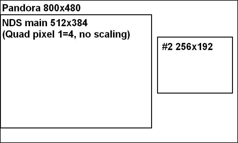

Scaling up the display would probably look crap though. With that amount of room to move, the emulator could show both screens at their native resolution within a full graphical representation of the DS, plus some ambient background scenery. :P
Not so silly actually, a few emus do this. Like NES on the GP2X, and iPod on the DS. I might mock up a screenie for the lulz later this afternoon, hehe.
He is right, I like SAIx2 personally, or quad (x2) pixel-ing, seeing as how this is so small.
I will post a picture of how I see it going.
http://picasaweb.google.com/nubie07/Pandor...780512536804882
There is enough room to quad pixel the main screen and still keep the full second screen. I am loving this resolution.

nubie's rendition is what I figured to be the most useful mode. It can also be done side by side scaled to fit. This doesn't really look that bad - GBA emulation on PSP is usually scaled + bilinear filtered, and while it does look blurrier and more washed out it's generally more than good enough to be considered worthwhile. With pixel shaders we can possibly efficiently implement custom filters such as bicubic filtering that look better. Another mode is just showing one of the screens (for games that don't really use the second), and for the few games that actually do depend on vertical orientation (ones that treat it like one big screen) it can be layered, which will look small but still be quite usable. All the extra space can provide touchscreen UI if desired.
@JakeK, who knows? but at this point we at least have a shot, it is the same architecture and at least double the clock speed (Quadruple?). Not to mention how much more RAM we have.
Hm, interesting setting. I personaly would like a vertical mode for the Pandora so you have the screen in portrait mode and we can see NDS screens over each other like at the real NDS. :) (They should be able to scale 2x or 1.5x in this mode maybe)
But sadly, the Design of the Pandora makes a useful portrait mode not very likeley. The lucky people who can get one of the first prototypes of the Pandora could test, if the Handhald is somehow usable in vertical mode. ^^""
