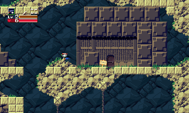

Hi there,
Here is NXEngine. It's an opensource engine for Cave Story.
Changes to the original sources :
- use scale2x to scale the graphics
- Widescreen support
- pandora control
Still todo :
- find why it slowdown for half a second regularly
[ Download ] - [ website ]

Found... But it doesnt realy help : every 2 seconds the musics buffers have to be filled which takes about 0.25s. That's the slowdown.
I keep looking at a solution :(
EDIT:
Uploaded a new version, changes :
- Centered scene that doesnt fit the screen
- fixed the stutters (the trick is to spread the work to fill the buffers in smaller batches)
it's now as good as it can get imho ;)

Scalling is done beforehand : on sprite loading. After that, no scalling is done when playing, so notaz SDL wont help much here.
What slowdown the game is music generation. Yep, you read right : the music is generated. From the code, it look like midi on dope.
The first PND I published shuttered : the game regenerated the music every 2seconds. and it took about 0.25sec each time.
So I splitted the job in smaller batches : now the game regenerate its sound buffer every 0.3s for a 0.07s impact. (as a matter of comparaison, AI + game event + redraw code cost about 0.02s every frame). Here are the solutions :

Add support for SDL_Mixer (the internal engine use dsp directly). Remove the current threading (as SDL_Mixer use it's own). Find everywhere in the code where it change musics/sound to adapt with the new api for SDL_Mixer... and hoping that CS dont use more than 1 tune at a time....

800x480 is the default mode, I should say the only one available (as the others will crash the game :D)
May be you should get in a cave larger that the original screen :)
