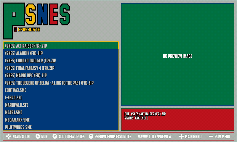

Here is PSNES, the Portable SNES.
This version of Snes9x is maintained by Cpasjuste, and is part of the PEmu suite. It use SDL2 and OpenGL (so gl4es). Default keymap should be Pandora compatible.

Oh, and your screenshotty thing up there is broken for me at time of writing.
@levi : yeah, it seems broken for me too, but when I edit, the link is correct, and the picture is shown correctly. So no idea what's wrong here. I'll re-check tomorrow, maybe it will be automagically fixed.
Oh yeah, that's weird. If I quote your message and pull the url out it seems to present a PSNES emu menu screeen as well. No idea why that isn't working at present, though I hope as well it just fixes itself, given I can't see what's wrong.
Edit: Just a temporary glitch it seems :)
