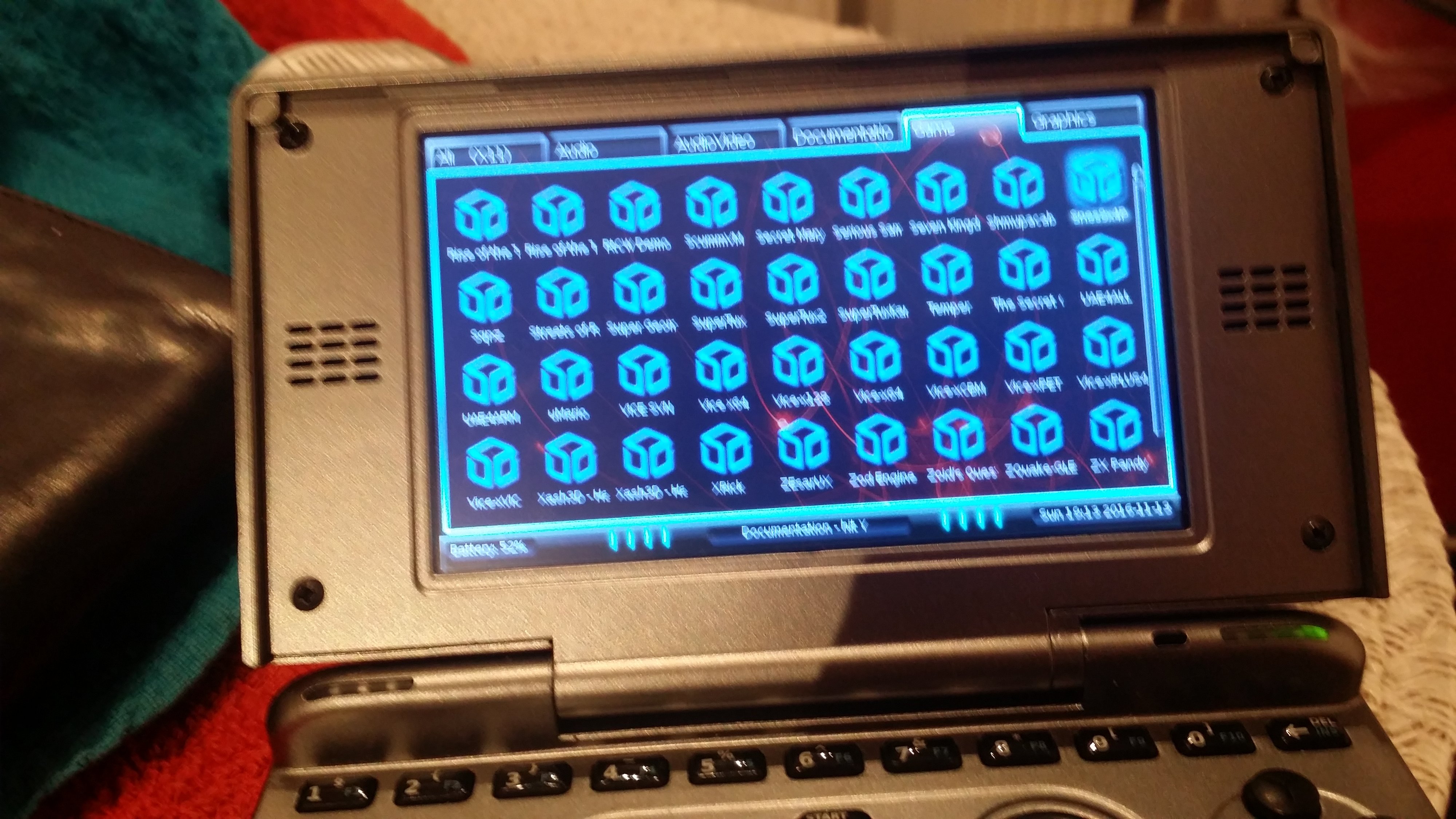

hello everyone. Any help on this. I have the lastest firmware installed. 1.75 update 4.
But when I boot my pandora up all i get is the same icons. They eventually go when i scroll down to other games and titles but i find this frustrating to look at.
Any ideas. I am using the 1ghz pandora. I also have 800mhz pandora with the same firmware and have no problems.
Ooh, minimenu! I don't generally test that any more, and I don't know many other people who do. It also might depend on your SD card and number of apps, since I guess, since it seems that it hasn't cached the pnd icons by the time minimenu needs them.
Never seen that, but Levi is probably right that it hasn't extracted the icons from the PNDs yet. Does using the 'Rescan' function (I think from the Select-menu) help?
Yes, the rescan option helped. But the problem was still there after I restarted the pandora up again. I have just flashed the firmware back to 1.74 and it's fixed the problem.
I doubt it's 1.75's fault, nothing changed in minimenu area, and it behaves correctly on 1.75 for me.
Maybe something was corrupted and reflash fixed it.
