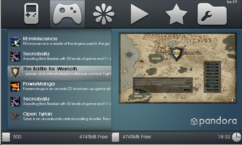

Finished my Shotgun theme
and it's uploaded to the FTP.
The font rendering is a bit shitty :/Paradox said:(naw)mcx said:Thanks to all the guys who offered me help and helped me, you're all awesome![]()
(dflemstr, tripmonkey_uk, trevsweb)
First peak at it actually running in pmenu
font could use some work
dflemstr said:OK thanks for the feedback guys...
Does this look better? (I can rearrange the bottom widgets if you think it looks better but I prefer to have the clock where it is, because PMenu can't right-align text so the clock would clip outside of the screen if it was to the right)

(naw)mcx said:The font rendering is a bit shitty :/Paradox said:(naw)mcx said:Thanks to all the guys who offered me help and helped me, you're all awesome![]()
You can already include a TTF or OTF font inside of the skin, which is better than any bitmap fontmap system out there (you can even take a bitmap ttf font and use that)Paradox said:would it be possible to use images for each number/letter? then you could use whatever font and it would look snazzy, if not maybe this could be a feature on the to-do list?
Well, the text scrolls... 'Nuff said.Paradox said:also, it looks a bit bad where the descriptions of things just get cut off, they should end with a few "..." before they reach the edge of the box so it looks cleaner.
what does it look like if there are more items in the lists than can be displayed, does a scrollbar show up? can that be skinned aswell?
No, PMenu doesn't allow for that.Paradox said:also in pmenu is it possible to display the time in 12 hour as an option? I mean I dunno what kind of features or configuration it has but i'd like 12hour time with AM/PM showing, if possible Cpasjuste

I'll have a look later! I'll see what I can do for you, babesParadox said:(naw)mcx said:The font rendering is a bit shitty :/Paradox said:(naw)mcx said:Thanks to all the guys who offered me help and helped me, you're all awesome![]()
the icons at the top might be a tad big too but maybe i'm just not seeing it as it would be on the pandora.
could you try some smaller icons with maybe text below them for the category names, just for me?![]()

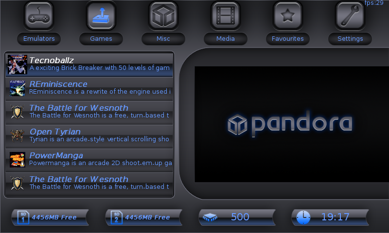

monkeyo2 said:I've tweeked the highlights on my Tungsten skin (SlashEMc2k was right, the lens flare looked shit!):
And I've also gone back an tweeked my first skin (that I've also renamed Magnetite as it slightly less bad than the old name), and made a few slight changes. I think fusion_power was right about the confirm box A & B being too dark, so they're white now, I've also made the Infos text a little bigger and have just tweeked the Category icons:
I think I'm happy enough with them that I can leave them alone now (and stop filling up Cpasjuste's FTP server! (you can delete the old ones now)). I'm looking forward to trying them out on the real machine!
