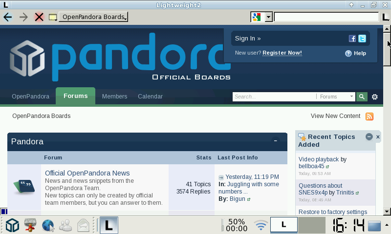

Hi, just found a new browser based on qt4, that is really small and fast.
http://qt-apps.org/content/show.php/Lightweight2?content=139266&PHPSESSID=932d06d57d7e55c225ea80b12c5e3628
Here is the pnd:
http://repo.openpandora.org/?page=detail&app=lightweight2-Lightweight2-112245
Thanks to buddha133 from german gp2xchat for testing!
Updated to 1.11

Looks good. So it's webkit based then? Or some other underlying engine?

mindlord: There is not much documentation, but I think it uses its own rendering engine.

Edit3: Browsing seems to be really nice and fast. And it didn't crash randomly for me while I used it.
Edit4: Downloads doesn't seem to work.

Edit: mindlord: It uses QTWebkit

Worked fine for me on HF4. Seems very stable as didn't crash once in several hours. Downloads dont work and I couldnt find any keys/ways to shut tabs. Also is it supposed to default to German, as most searches gave the German results and I had to add UK to the end of everything to get British shops/sites etc.
shut tabs by rightclicking on it and choose shutdown. For the german defaults: It is made by german developers. Maybe this is the reason. And it is their first release. So don't expect too much.
