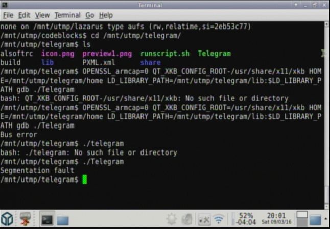

So I decided to work again on that right-click crash bug this Weekend. I started a gdb session with current build this saturday and find out that I had to rebuilt Qt (a special static lib build) with debug info to be ebble to go further in the debug
So I started rebuilding Qt.... It finished sunday afternoon... Than I had to cleanily recompile Telegram itself (because of changed PCH files)... It ended this monday morning.
So I quickly started a new debug session before going to work... to find out it doesn't crash anymore!
So I just took that binary, stripped it and create a new PND... Qt is a debug build, not a release build, but I don't think the missing optimisation is really important for that type of software.
Build 09
Here is the (short) gdb sesion
