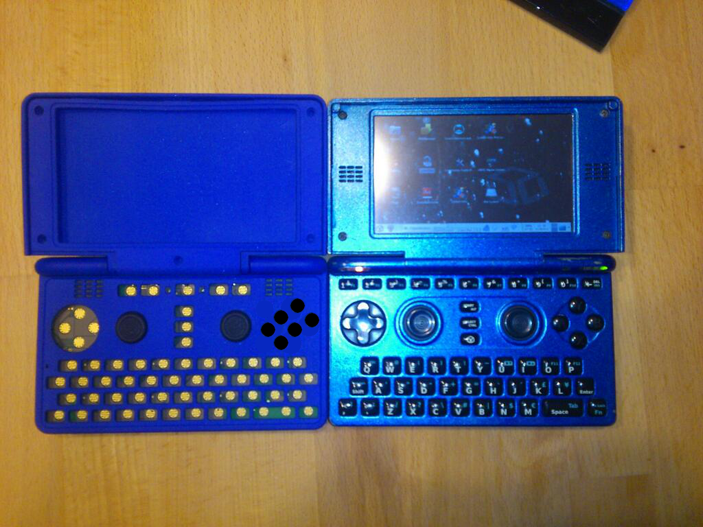

I've been busy, so I haven't had time to come up with a poll about the 6-button layout yet. However, I figured I'd go ahead and put up these 2 mid-sized button versions I put together:
1) Larger than my small example
This would be just over 1mm smaller in diameter than the Pandora buttons.
2) Slightly larger than (1)
This would be just under 1mm smaller in diameter than the Pandora buttons.
As is illustrated by each second image, both options do not conflict with the nub's under-disc.
I will try to make a poll for the different 6-button options by the end of this week. I'm on-call tho', so I'll see when I have time to make it.

I do make some hack like I did with my shoulder buttons for the 6 Button layout.
Then EvilDragon can test it and we can see if it's well usable.
As buttons I'll use Nintendo DS Light buttons and Keymat. Thea are slightly smaller than Pandora Buttons but still usable.
Smaller would be no good I think.
I have to wait until the Parts arrive and finish everything on Friday.
I'm not sure if it will work but don't see a reason why not.
If you have to make a poll please wait until we did test.
If both solutions do work then you may have your poll.

I'd like Select and Start, as thin as they are, to be positioned more like the T and Y keys on the Pandora. :)
To solve both our problems with these keys I'm curious if ED could make the three center keys each about 1/3 longer. It would make them easier to reach and to push. We do have the physical room to do this modification afterall.
Sorry, but I still like ED & team's solution of adding the 2 extra buttons on the left.
The 2 rows of 3 change would require case & motherboard & keymat changes. I would much rather that the project stay on course with what they've got - which is damn good and highly innovative.
Is there any explanation of the electrical specifications of Pyra or Pandora's buttons. From what I understand there's a conductive part on the keymat which presses on the pads on the PCB and closes a circuit (which is then detected as button press). In other words, the standard way buttons work on on controllers.
I was thinking that custom button layouts could be achieved by removing the button caps and then placing a custom made part with the new button layout on top. This new part could snap into the button holes (to hold it in place).
Problems would be achieving a low enough profile to avoid the LCD when the clamshell is closed and connecting back to the PCB so that button presses get detected.

 Now that you mention rotating the buttons, I think that Saber's idea would be more feasible if they were rotated at a 45deg angle similar to the start and select on the SNES. I'm not so sure how fond of the side-by-side start and select buttons idea I am, however, that would probably be the best way to save space and still implement Saber's idea.
The keymat hasn't been finished yet, so changes to that don't matter. EvilDragon has stated case changes are not a problem and has indicated that there are parts of the case design still in flux. Motherboard changes are also not as bad of a problem as they would be for another device, considering that the peripheral board is the one that would have to change, which is a lot simpler of a board to change thanks to the SoC having a daughter board.
