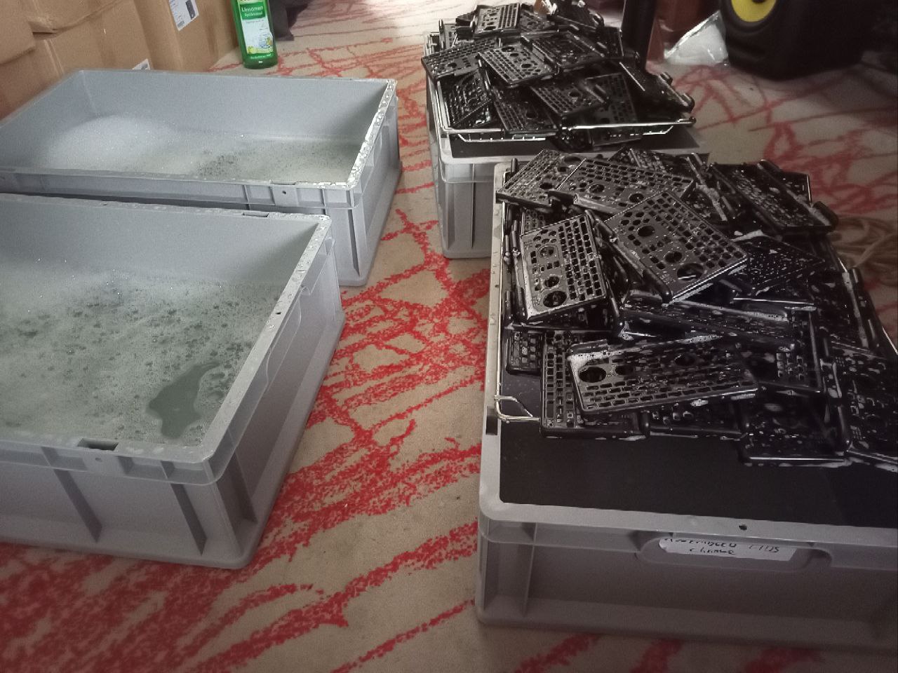

Get baptized so that your sins will be washed away. That's right, as a Christian I did not allow any further Pyras to be delivered, if not each part of the case was baptized by my own hands.
Actually, this was some big mess. The new unpainted housings we got were not cleaned properly by the manufacturer. On the housings, there was some oil or whatever film applied, so that the housings will eject more easily from the mold. However that makes the paint not stick properly on some areas, which will lead to some ugly results.

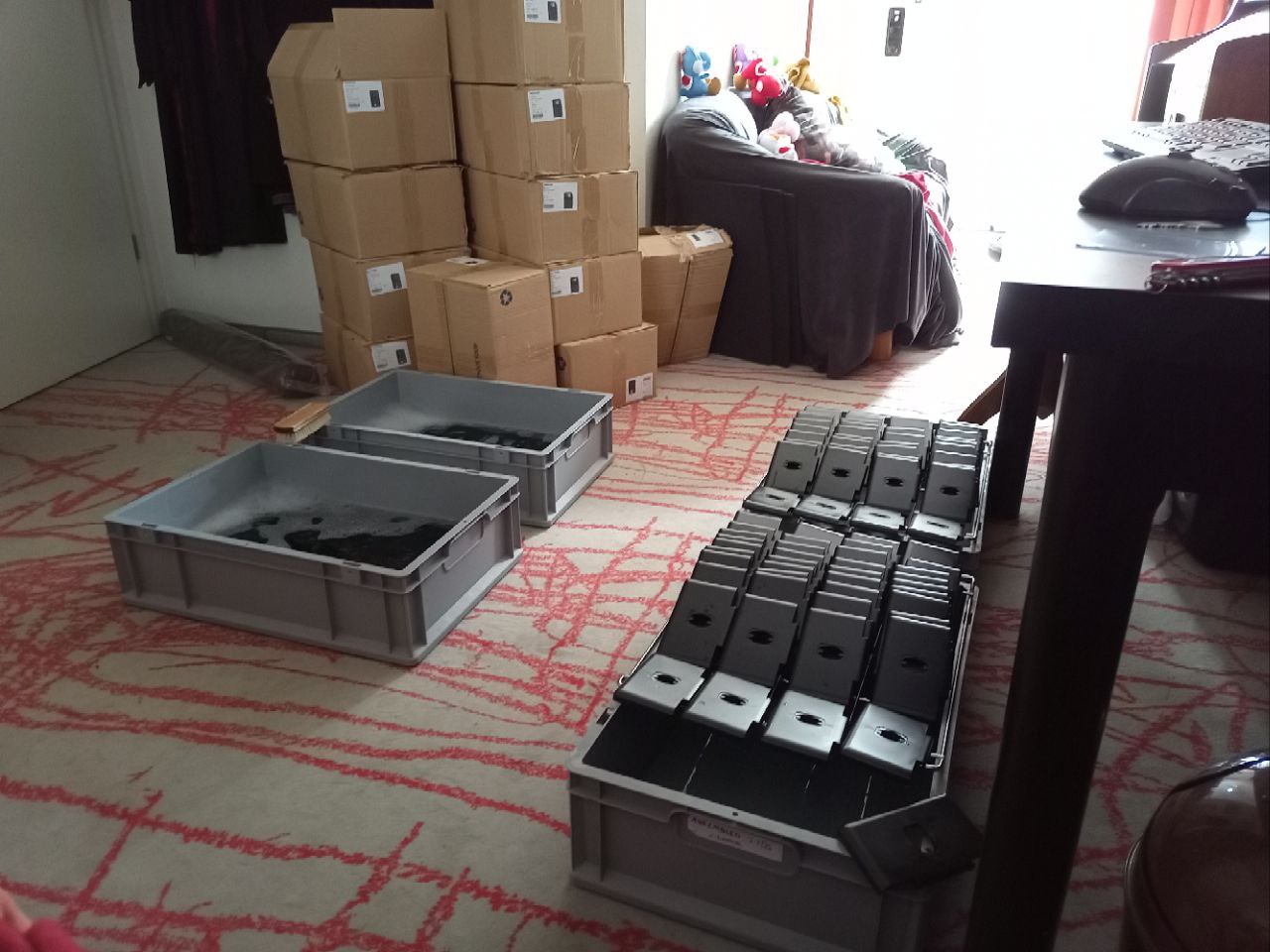

This is the point now where we shifted the production to mostly my house. I took all the housings with me and started the big cleaning. Every piece of housing was put into a pool of soap water for about 2 hours. When taking it out, I quickly brushed each one, just to make sure it was properly cleaned. Luckily it turned out that soap water was enough, and we did not have to clean them with Isopropanol, which would have taken forever.

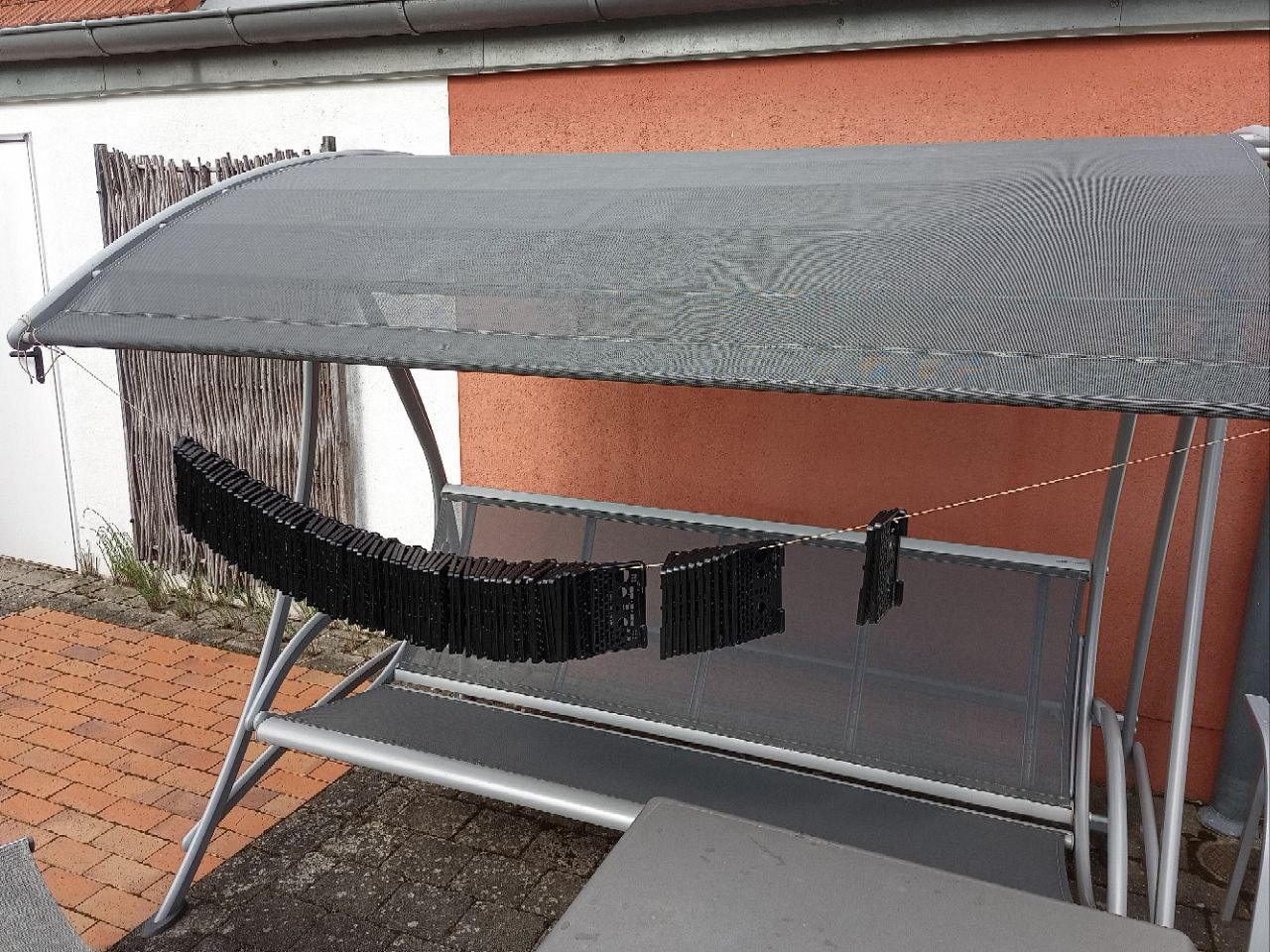

It might not seem obvious but drying the whole pile of casings efficiently was also a bit of a challenge. I went quite creative at first
This was not super efficient and I was afraid that the housings might scratch. I ended up with the following: First I put the wet housings onto some grid, so that the water could drop off. I helped a little with a battery powered leaf blower.
Before the next batch of housings was ready to be taken out of the water, the ones on the grid were put on a rope and put on the ground in a certain angle, so that the remaining water could flow off and not leave some traces;
This procedure took several weeks. I could only do 3 boxes of housings per day because this was quite taxing on my back (doing this all on the ground is not an ergonomic workflow) and very time consuming. Further, my official contract is only for about one and a half days per week and at that time I was not motivated to do more than that. Not the least because I needed to rest my back after 2 days of cleaning.
Don't worry, my back is healthy and I recover from such work loads quickly. It's not like I do this all the time :)
Check out the huge chunk of boxed I had in front of me.

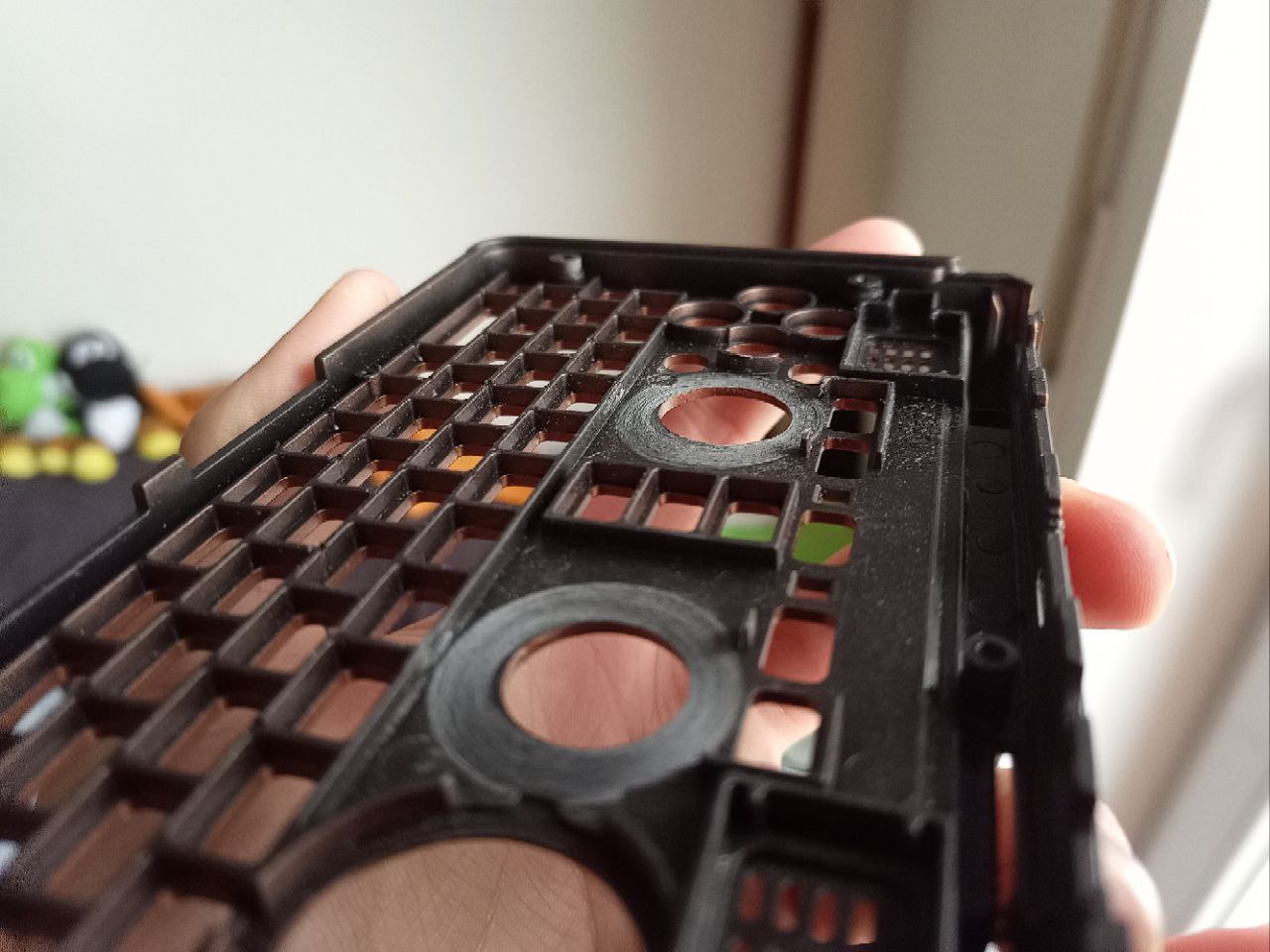

Nubs

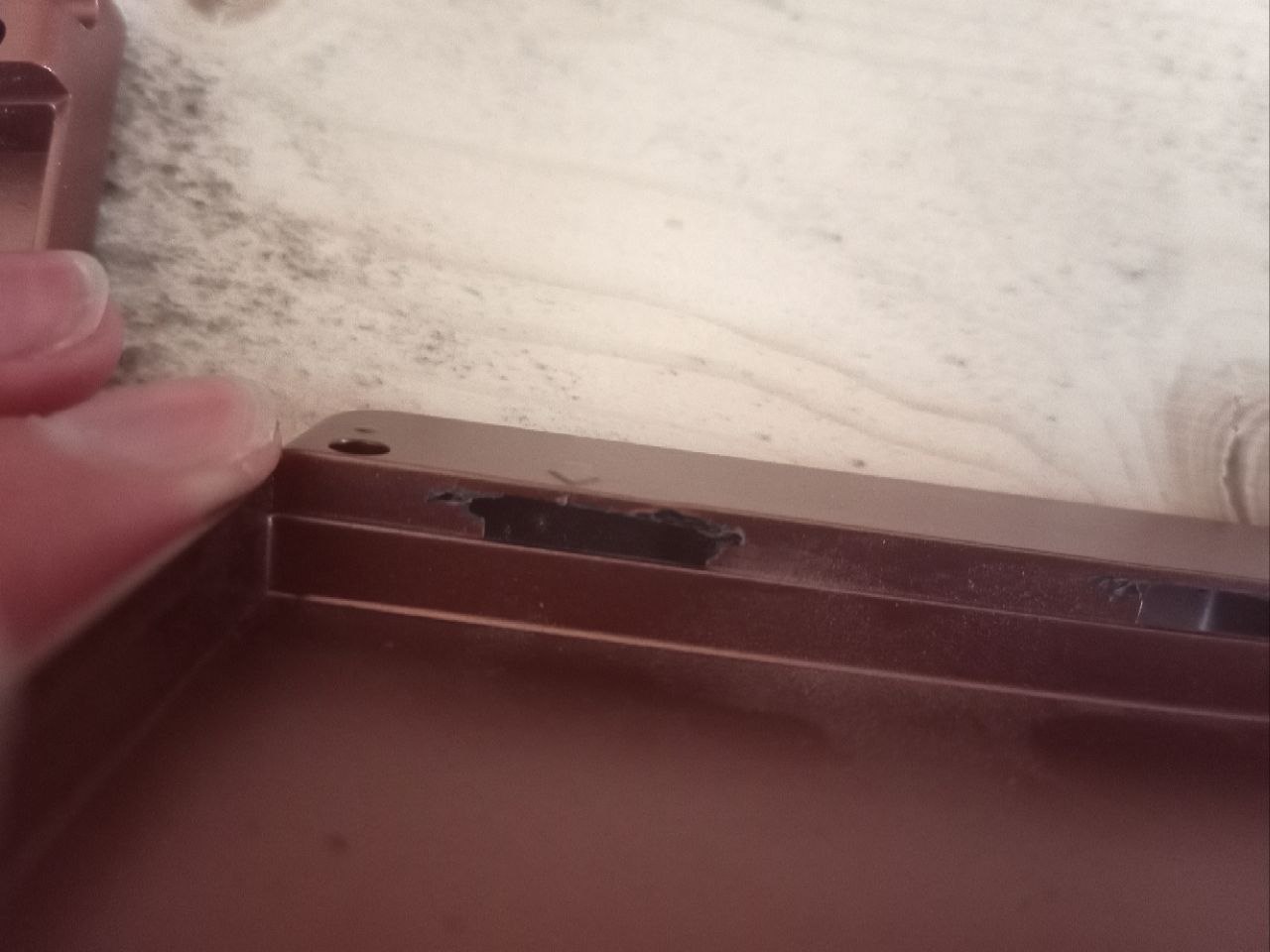

It's not the nubs themself that are problematic. Somehow more often than not there is not enough room inside the housing for the plastic head to move 100% freely. This results in some friction and causes some nubs not to return to center position properly once they are released.
The solution to this is to remove like 0.1mm of materil from the housing in the area where the nubs are located. What might sound easy is like the biggest and most time consuming step in the whole process. Those housings are quite sturdy and there is not efficient way to remove that plastic in a wide are simultaneously. At first I tried a forstner drill, however even a new and sharp drill head could did not work. The housing was not only hard but also very sleek.

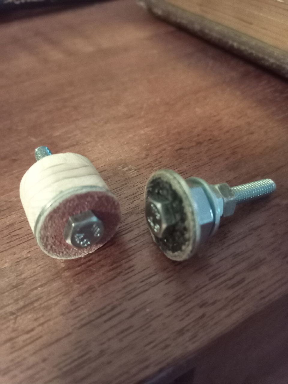

In the end my father suggested to cut a piece of sand paper at the desired size and tape it onto a washer of the desired size. That way we made our own drill which turned out to be quite a functional solution.
Even though we have a drill stand that allows to move the drill head down, I still could not go that route and needed to manually press each piece against the self made drill head. That is because of heat. Even with a slowly rotating head, the housing starts to become warm quite fast and if too much pressure was applied or the procedure went on for too long, the housing melted. So I needed to manually tilt the housing below the rotating drill head and keep my fingers on the other side to apply counter pressure and to be able to react immediately, once the heat emerges.
Further I did two runs for each housing, at first with a rough sand paper (right one) to remove the material and make the surface rough. After that I used a fine one (left one) to polish the surface and make sure that the nubs will have nice conditions for free flow movement.
Here is the result

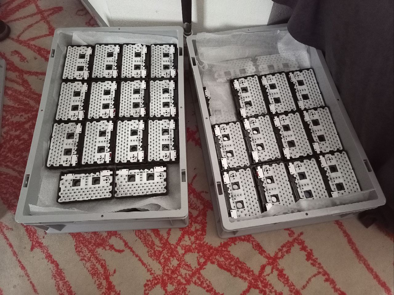

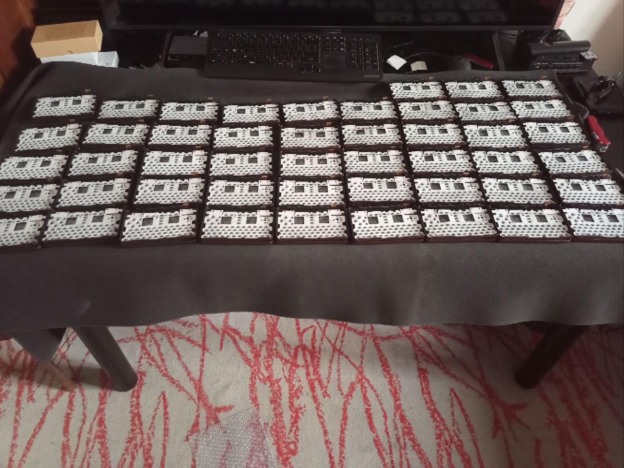

The rest of the copper production went quite smooth. There are quite a few (extra) steps involved while preparing the housings. However those are just small cuts or other quick actions that do not take too much time if it's all done in a batch production.

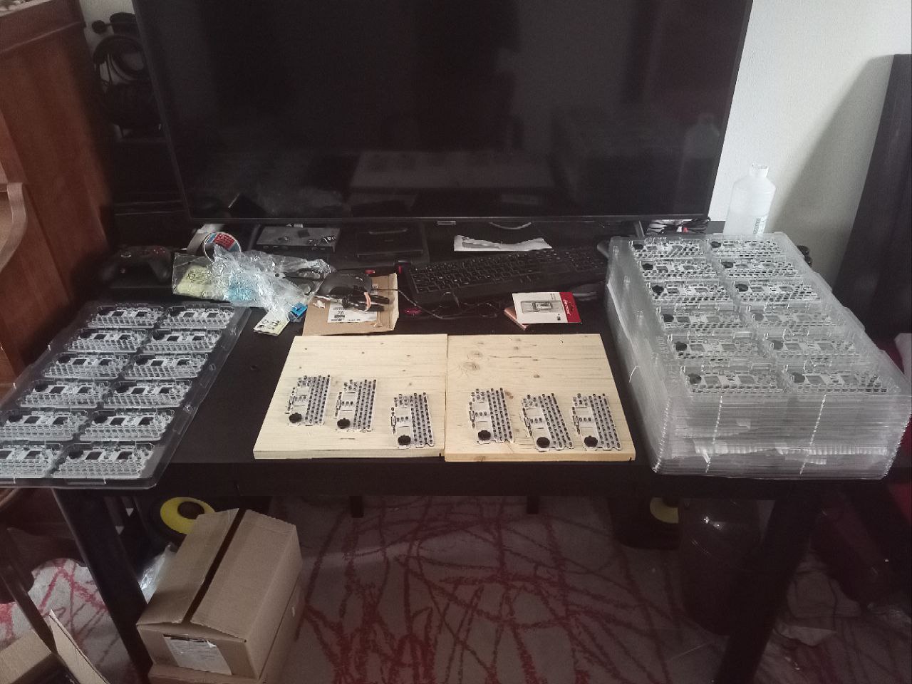

I have a really big desk here for work and once I clean it all up, I can fit a bit over 50 housings on it at the same time. This is a nice batch size to work with.
Here I'm having some fun with key mats for example

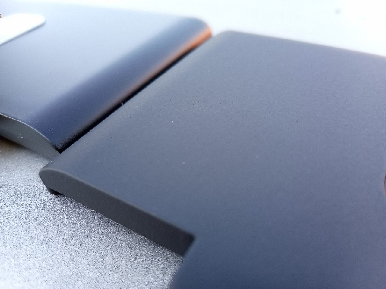

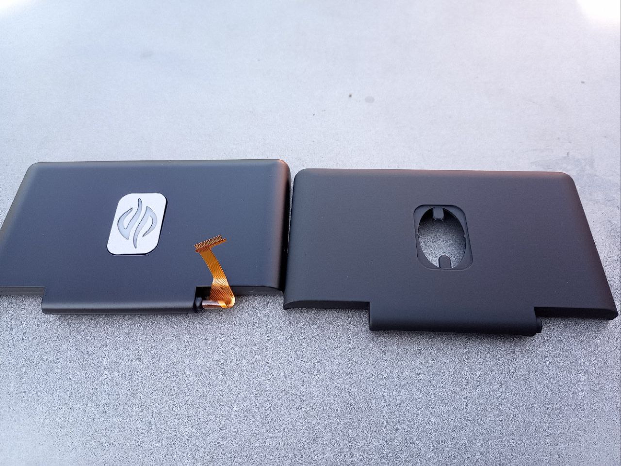

However there was a huge surprise inside those boxes: The paint was different. It's not just that the black paint was way easier on the battery lid mechanism.
It was also different than the old black paint.
Oh my god this thing looks and feels so premium. It's a bit rough and matte. The old black is a bit glossy and sleek. The new one is not reflective at all and has a nice rough texture.
Here are some pictures. The right one is the new one.
So in the end, painting the whole case was the right thing to do. This is a pleasant surprise.
However there is one downside. It seems like the new paint is way more vulnerable to scratches. Once or twice I slipped off during production and my finger nail left some trace. The old one was quite more sturdy.
I snatched off a housing for myself but still did not apply it to my Pyra. I have no idea how the new paint behaves in the long term and if it will degrade over time.
At the current moment however, it looks great.

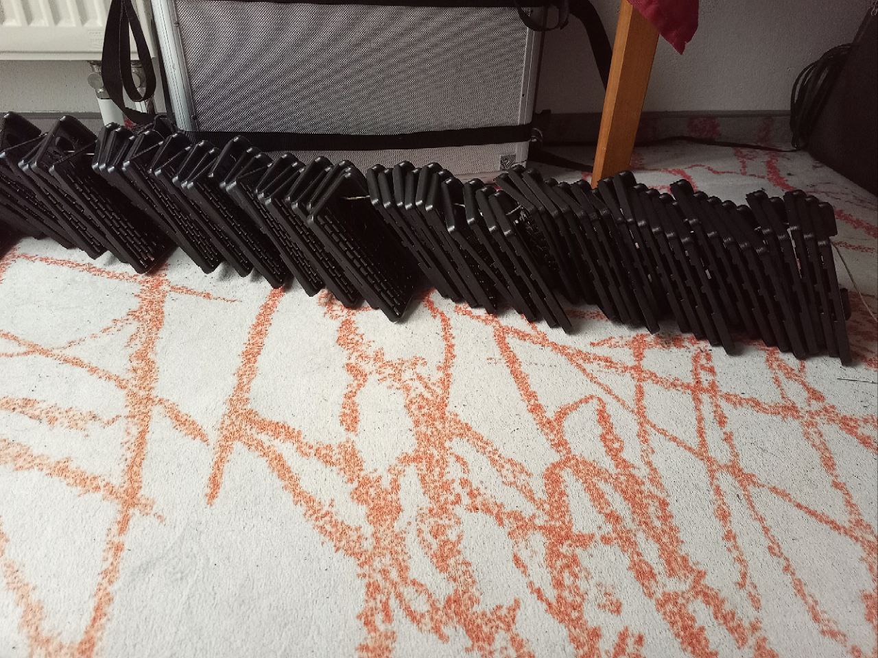

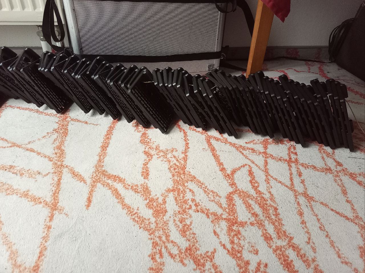

Since I will not be available indefinitely and I had an other spark of enthusiasm, I went all in and spent 1 1/2 weeks doing non-stop Pyra work. (To put things in perspective, just doing the nub rework took a whole day. It's crazy how much time this takes).
Here is the result: 137 black shells, awaiting their PCB
I wonder if you could set up some cheap table with some plastic sheet on top to protect it and leave the case on the plastic so that they don't dance to the wind and scratch, but you don't have to do it all on the floor ?
Maybe not even a table. Even some cardboard boxes with a bit plastic sheet on top ?
It might not even be legal to work more than what the contract says...
Still, take care of work related health hazards...
Not sure I understand but it sounds dangerous. Take care.
Well, the new black looks great. I don't mind scratches, I think. The older my Pyra looks the less attractive to thieves.
It's a surprise, will one get a new or old painted Pyra? how will the paint survive ?
