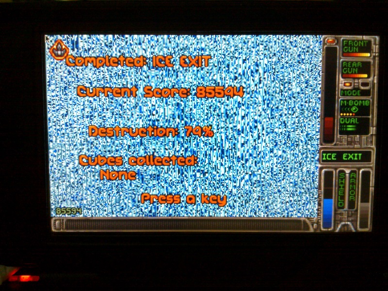

The level "ICE EXIT" has a graphical glitch, the background doesn't display properly.
Are you sure that isn't just the ice?
Well could be a bug, but I need to figure out how to skip levels to debug this.

Yes I'm sure that's not the way it's meant to look, Enemy shots (snowballs) are near invisible and the background moves constantly. Try the attached savefile, first savegame, last level is called "?TUNNEL?" - which reads kind of wrong, too.
All in all this runs a whole lot better than that old version from the "appstore" and is heaps of fun. Thanks a lot!
Edit: The charge beam doesn't charge, but fires away constantly.
Edit2: Is it tyrian an easy shooter compared to others? I am a side scrolling shooter newb and suck at other games of that genre, but here I progress rapidly. Episode 4 now, almost maxed out, only like two or three levels gave me a hard time. I'm playing on normal with slow movement. Maybe I should go faster...

Okay thanks for the save state, even with cheats I can't seem to hit that level... it must need to be unlocked?
I will test the charge beam and the level issue with the same source code compiled on PC vs Pandora and see how it behaves..
