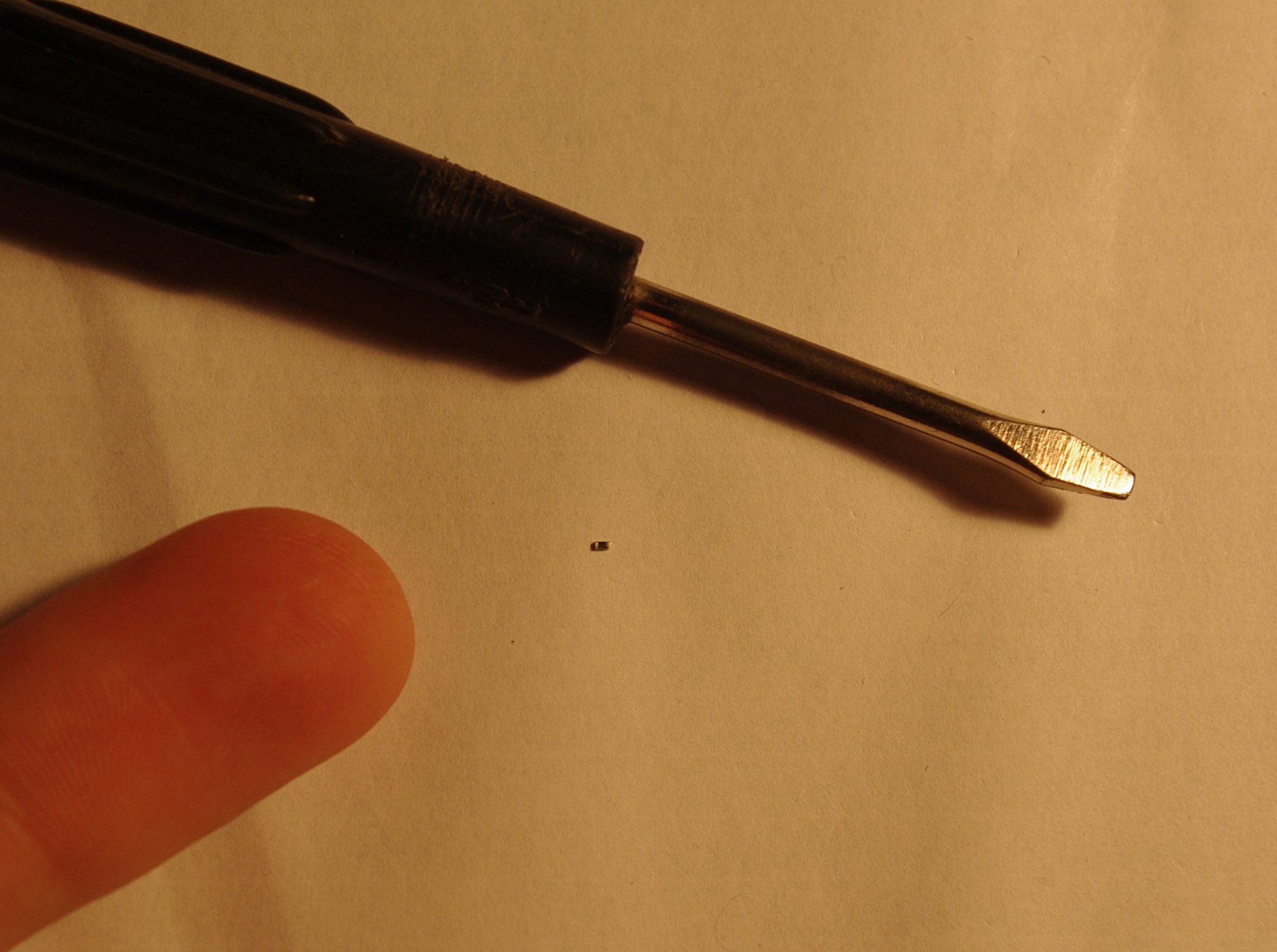

Just had some hard time attempting to mod my board. That resistor is really small, see for yourself (my index finger and small screwdriver for comparison):
not sure if I got it right, at least my pandora still boots..

<br>Just had some hard time attempting to mod my board. That resistor is really small, see for yourself (my index finger and small screwdriver for comparison):<br><br><br>not sure if I got it right, at least my pandora still boots..<br>
Mine were mod'd today too, we measured the resistance with a meter and both were at the expected value. And your right those resisters are small, grain of sand.I will be able to test out in a few hours :-)
Dead1nside said:
Bloody hell, and I had those large ones from DT in my mind. I bet you can't read the colour banding on that!
That's why these have no colour coding (SMD resistors have numbers printed on them) ;)
just keep an eye on them. i lost one of these bastards on a carpet when i was overclocking an old imac recently. that was a nightmare searching for it ...
A tip if you are soldering them with an ordinary iron: Glue them on a needle tip first with a semi-fluid cyanoacrylate glue ;)
Oh god, I would not want to try soldering that. I tried soldering a variable resistor to a small leg of a chip on my 9600GSO...managed to rip the traces off of the board and the leg off of the chip.
That was the last time I used that radio$hack soldering iron, got myself a 20W Weller iron. I'm still terrible though.
Wow. Such a tiny little bastard can cause such a mess? I'm sure, notaz don't let him live and want revenge for all these stressful weeks of WiFi bug hunting. :D

@notaz
Wow! That resistor is tiny! You have to have major skills to solder that on in the right place! I'd probably accidently cover the whole thing in solder :lol:
