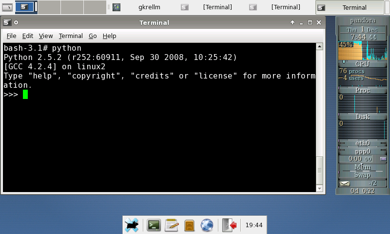

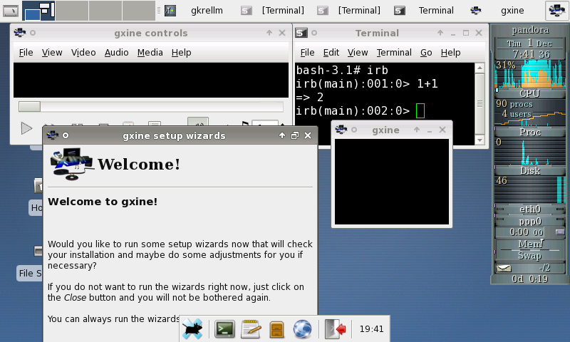

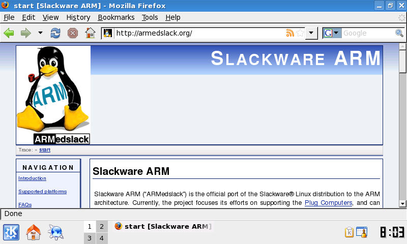

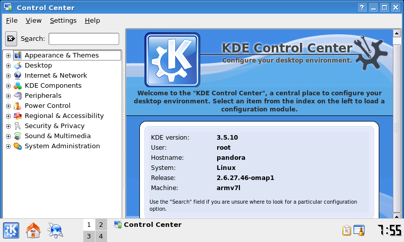

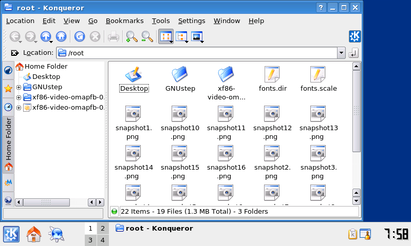

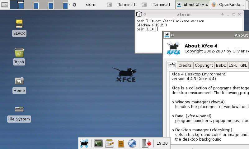

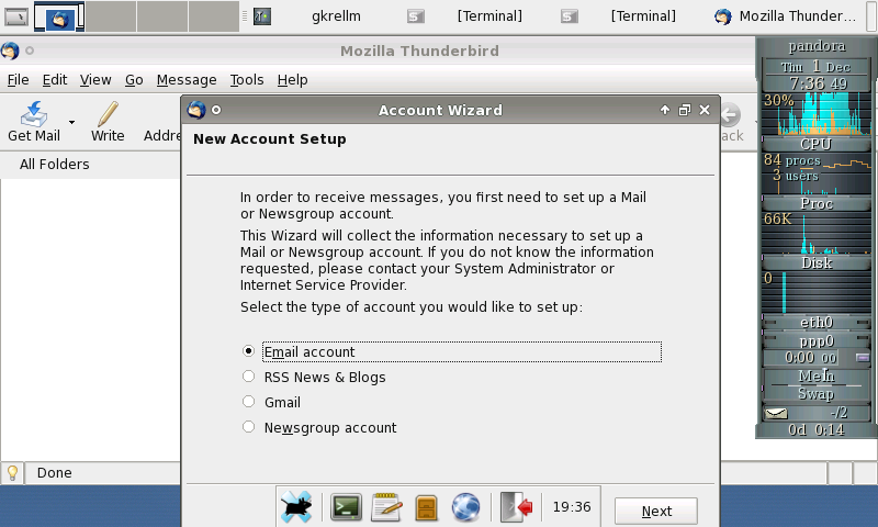

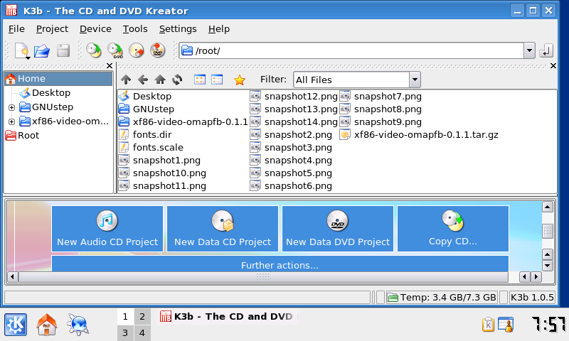

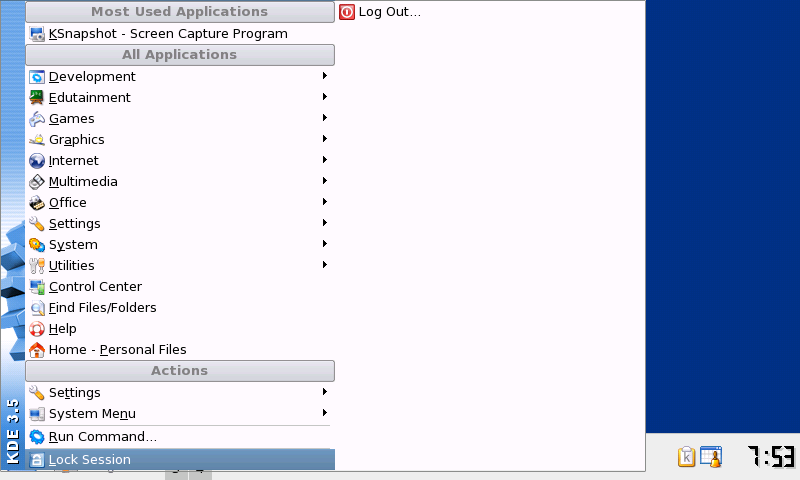

Slackware inside Pandora.

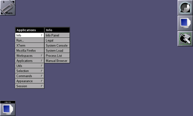

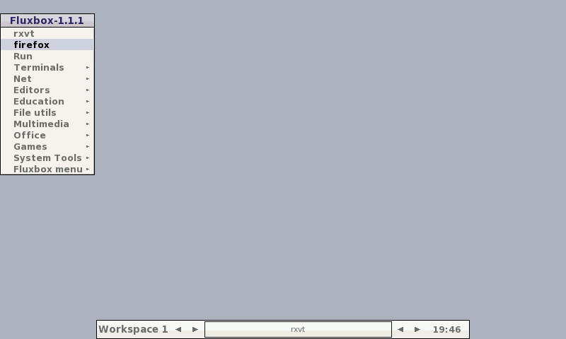

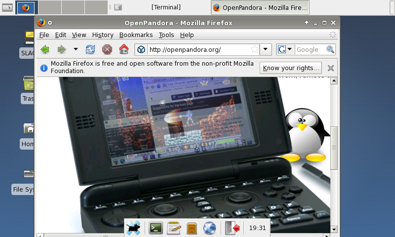

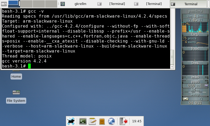

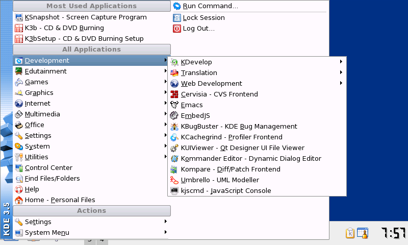

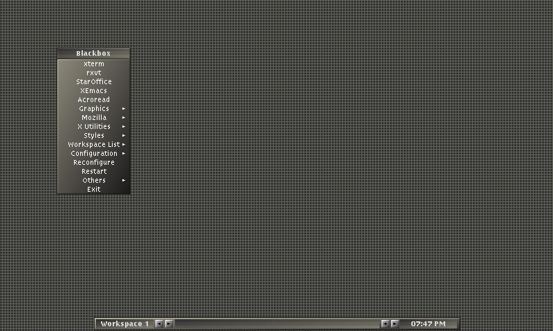

Hey, Linux-SWAT, drop some screenshots from SLAX on OP.
BTW. Thanks for Your work..
It's ARMedslack, the official Slackware port on ARM, not slax ;^)

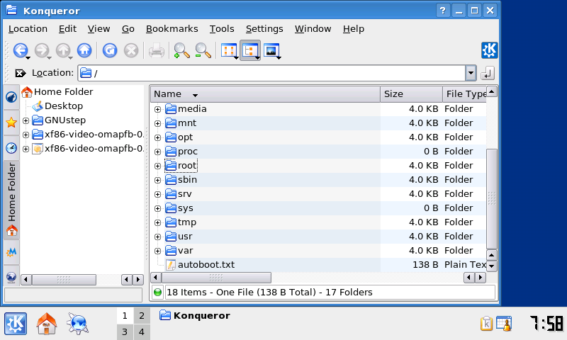

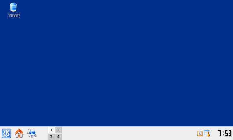

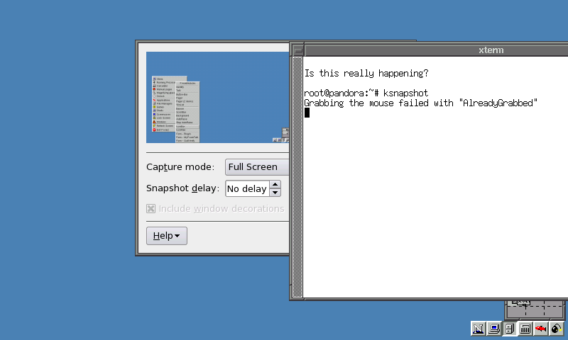

A little surprise beginning at shot 12.

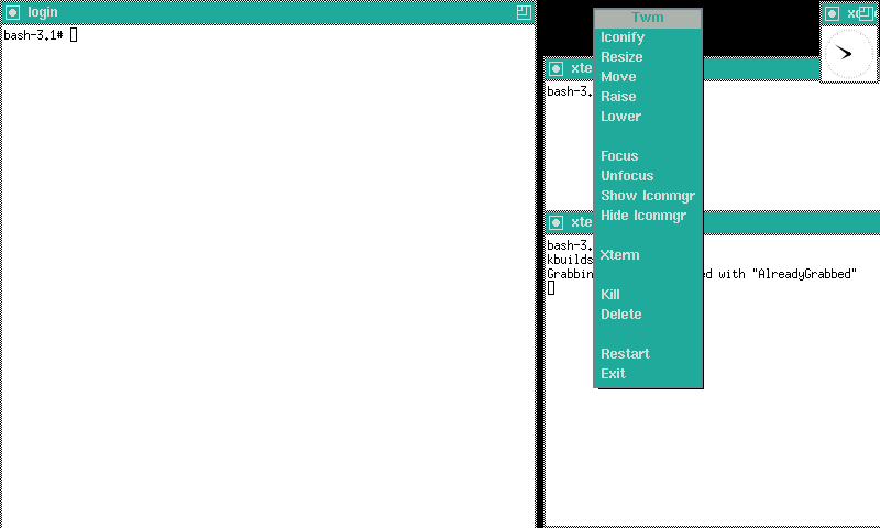

Also: You know you're old when you get a nostalgic feeling from a TWM screenie :D
I would love to show more, this touchscreen is getting me mad.
