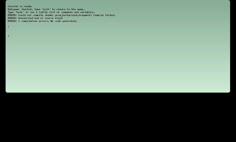

I get this kind of error when starting Grim Fandango or Escape From Monkey Island on a CC Pandora when using the default renderer:
PND : /media/polaroid32gb/pandora/menu/residualvm.pnd
PND_FSTYPE : Squashfs
APPDATADIR : /media/polaroid32gb/pandora/appdata/residualvm
APPDD_FSTYPE : ext4
PND_CPUSPEED : <unset>
EXENAME : runscript.sh
ARGUMENTS : <unset>
Mounting : mount -t squashfs -o ro "/dev/loop0" "/mnt/utmp/residualvm"
Mounting the Union FS : mount -t aufs -o exec,dirs="/media/polaroid32gb/pandora/appdata/residualvm=rw+nolwh":"/mnt/pnd/residualvm=rr" none "/mnt/utmp/residualvm"
[SUCCESS]--- Mount the PND ----------
[ START ]--- Starting the application ( runscript.sh ) ----------
Setting PATH to /mnt/utmp/residualvm:/mnt/utmp/residualvm/bin:/usr/local/sbin:/usr/local/bin:/usr/sbin:/usr/bin:/sbin:/bin:/usr/bin/X11:/usr/games
Setting LD_LIBRARY_PATH to /mnt/utmp/residualvm/lib:/lib:/usr/lib
WARNING: FSDirectory::cacheDirectory: name clash when building cache, ignoring file 'VOX0000.LAB'!
WARNING: FSDirectory::cacheDirectory: name clash when building cache, ignoring file 'credits.lab'!
WARNING: FSDirectory::cacheDirectory: name clash when building cache, ignoring file 'year0mus.lab'!
WARNING: Could not get GLSL version!
User picked target 'grim-win' (gameid 'grim')...
Looking for a plugin supporting this gameid... Grim Engine
Starting 'Grim Fandango'
EGLport: Closed
EGL NOTICE: Unable to read ini settings from file 'eglport.cfg'. Using defaults
EGLport: Opening EGL display
EGLport: Using EGL_DEFAULT_DISPLAY
EGLport: Initializing
EGL Implementation Version: Major 1 Minor 4
EGL_VENDOR: Imagination Technologies
EGL_VERSION: 1.4 build 1.4.14.2616
EGL_EXTENSIONS: EGL_KHR_image EGL_KHR_image_base EGL_KHR_gl_texture_2D_image EGL_KHR_gl_texture_cubemap_image EGL_KHR_gl_renderbuffer_image EGL_KHR_vg_parent_image EGL_IMG_context_priority
EGLport: Found 2 available configs
EGLport: Using Config 0
EGLport: Binding API
EGLport: Creating Context
EGLport: Creating window surface
EGLport: Making Current
EGLport: Setting swap interval
EGLport: Complete
INFO: OpenGL Vendor: Imagination Technologies
INFO: OpenGL Renderer: PowerVR SGX 530
INFO: OpenGL Version: OpenGL ES 2.0
INFO: GLSL version: OpenGL ES GLSL ES 1.00
Could not compile shader grim_background.fragment: Compile failed.
ERROR: Unexpected end of source found
ERROR: 1 compilation errors. No code generated.
[ FAILED]--- Starting the application ( runscript.sh ) ----------
[ START ]--- Restoring the frame buffer status ----------
[SUCCESS]--- Restoring the frame buffer status ----------
[ START ]--- uMount the PND ----------
[ START ]--- Waiting the Union to be available ----------
[SUCCESS]--- Waiting the Union to be available ----------
rmdir: failed to remove `/mnt/utmp/residualvm': Device or resource busy
[ START ]--- Waiting the PND mount dir to be free ----------
[SUCCESS]--- Waiting the PND mount dir to be free ----------
cleanup done
[SUCCESS]--- uMount the PND ----------
Return code is : 5
Both games started when I switched to software renderer, but Grim Fandango seems to run a lot less smoothly than with the previous ResidualVM PND, especially in the cutscenes.
This seems to also require a big swap file. Grim Fandango crashed during the intro cutscene when I only had a 1 GB swap file enabled, but I could watch the whole cutscene with a 2 GB swap file.
